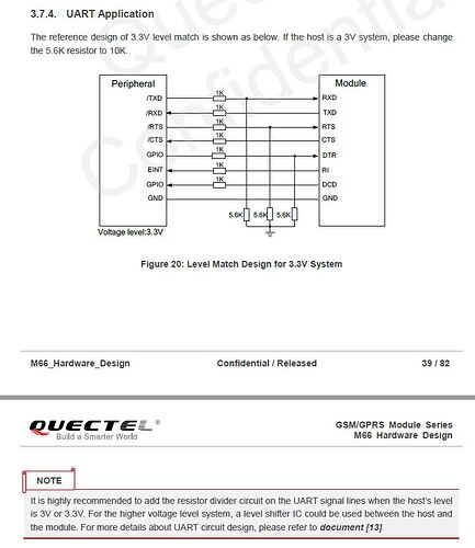

When you turn on the module, UART interface will be active and the module can receive AT commands and reply all commands. There is no need to activate the listening mode. If you cannot get any response from the module, there may be a hardware problem or software.
The IO voltage level of UART is 2.8V so first please check your UART interface design or check UART_USB converter is suitable for 2.8V or not.
