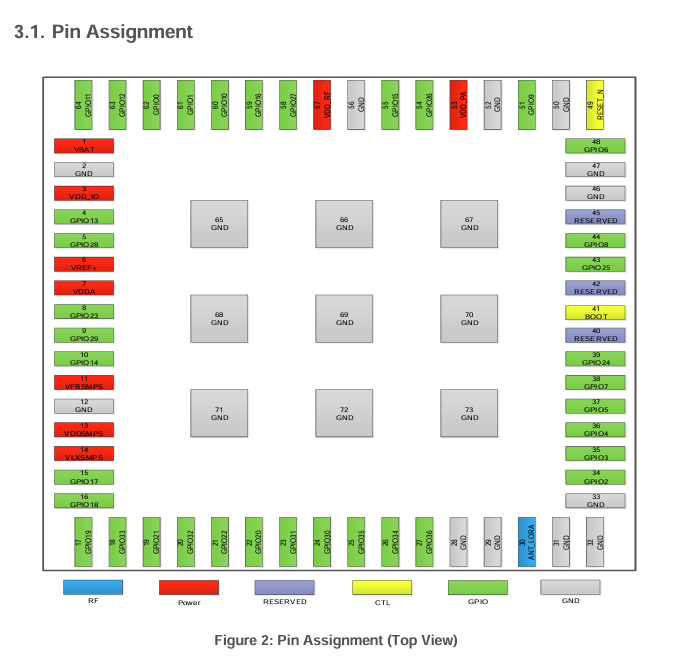

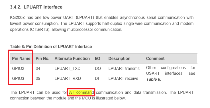

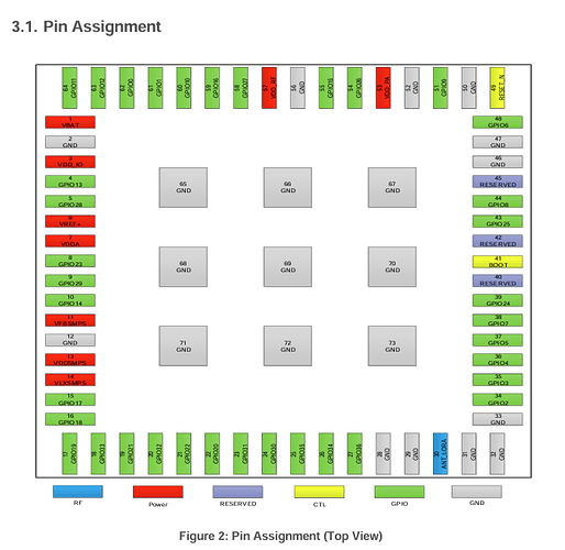

Hi, the AT firmware works on LPUART1, GPIO2 and GPIO3.
Hi Pew_Pew,
Do you have the Hardware Design for this module? I can email to you if required. You can find the info through there, please refer below:
Pin assignment:
LPUART Interface
