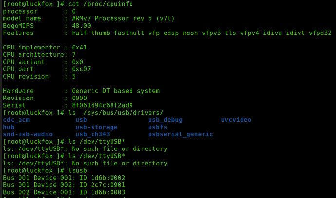

I am also interfacing the Quectel EC200U module by 7Semi with Luckfox Pico Mini B Linux Board. I have enabled USB generic serial driver in SDK and compiled it. Also I have set Luckfox Pico board USB C port to host mode and connected to ec200u module via USB. I am powering EC200U from external power supply. When I enter lsusb it shows usb device as 2C7C. But I need to know the further process for providing internet connectivity. Please help me.

Can you see the /dev/ttyUSBx and the usb0 interface?
Please show
ls /sys/bus/usb/drivers/
Make sure we can see the /dev/ttyUSBx and usb0 first.

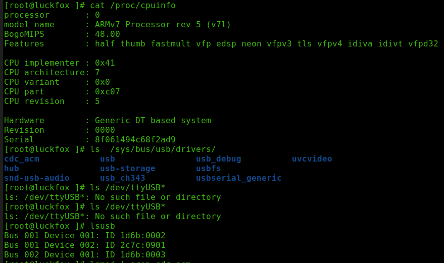

I am not able to see /dev/ttyUSBx or usb0 interface. Check image.
Just for sending AT command, you can try
echo 2C7C 0901 > /sys/bus/usb-serial/drivers/generic/new_id
then you can see the ttyUSB.
You should enable the option driver and cdc_ether driver.
Thank you so much. My issue has been resolved and I successfully interfaced the EC200U module through USB and established internet connection with Luckfox Pico device using ppp0.
