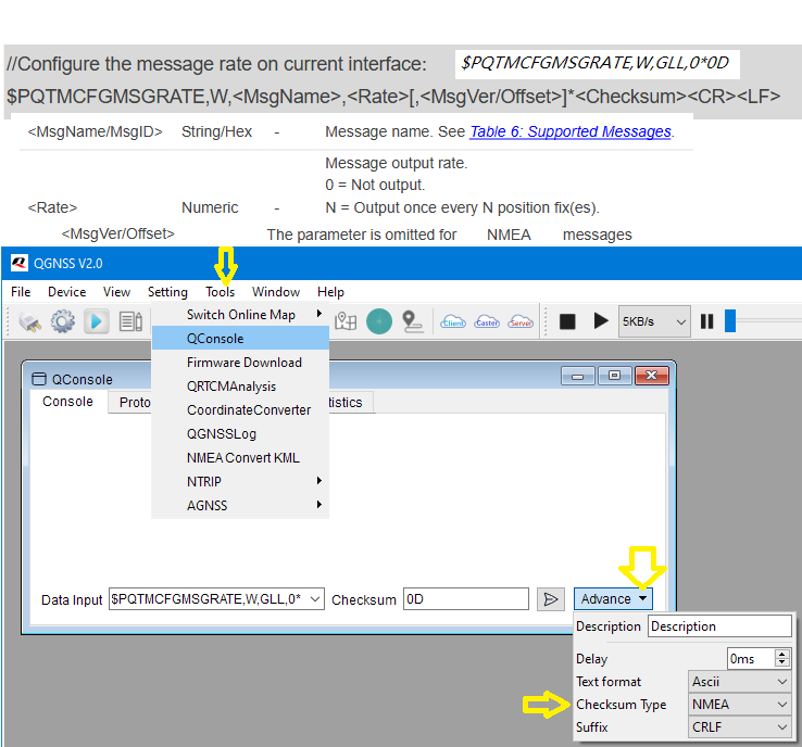

By the way, is there any way to disable NMEA messages? From what I understand, the GNSS protocol doesn’t allow for complete disabling, but I wanted to check if there’s a workaround.
https://www.quectel.com/content/uploads/2024/07/QGNSS_V2.0_EN.zip
But can I get only position info each second, or i will receive all data at this time config ?
Other modules has mask for commands send. this one looks to be masking types of satellites used.
is in GGA (or RMC) sentence, so U can disable all other nmea,“one at a time”, by rate (0) with PQTMCFGMSGRATE
note: nmea messages vary depending on fw version.
