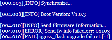

the strange is that the lower I have in my log is Boot Version: V1.0.3
and the error became if the fw is incompatible
so the latest is Boot Version: V1.0.6.
https://www.quectel.com/content/uploads/2024/07/QGNSS_V2.3_EN.zip
