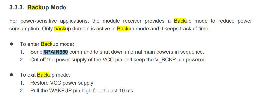

Hi,
This might be a silly question.
If the LC79HALMD module is placed in Backup Mode, and the module is reset by driving the RESET_N pin low for more than 100ms and then releasing it (after restoring VCC), will that take the module out of Backup Mode?
Thanks and best regards.
Hi patrik,
Thank you for your question, it’s not silly at all!
Yes, it will out of Backuo Mode.
Best regards!
