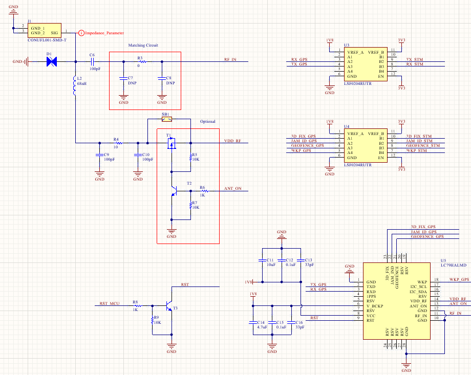

Hi, could you tell me if my schematic is correct, please?
I’m using 115200 baudrate, parity none, one stop bit, 8 bits, but I don’t get communication with the gps module.
My firmware does the following:
RST_MCU goes to high
Delay(500 ms)
RST_MCU goes to low
Delay(100 ms)
WKP_GPS goes to high
Delay(50 ms)
WKP_GPS goes to low
Enable UART_RX interrupt reception
Hi @edgar.cabana
I am sorry for the late reply. Could you please provide the entire module model, like LC79DCMD.
Best regards.
