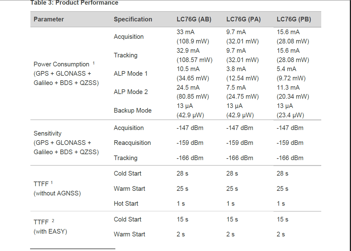

While measuring the module consumption in acquisition stage I’m having 17.4mA. resulting on being more on the side of 30/31mW.
Is this expected? where I can find the maximum and minimum for this LC76G-PB modules?

For the consumption on LC76G (PB) which you shared was tested at room temperature with typical operating voltages and satellites signal of -130 dBm configured by the instrument.

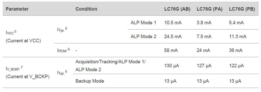

For peak current, in the Hardware Design document, you may refer to Chapter 6 Electrical Specification: 6.3 Supply Current Requirement. The peak value for Ivcc for LC76G (PB) is 36mA.
