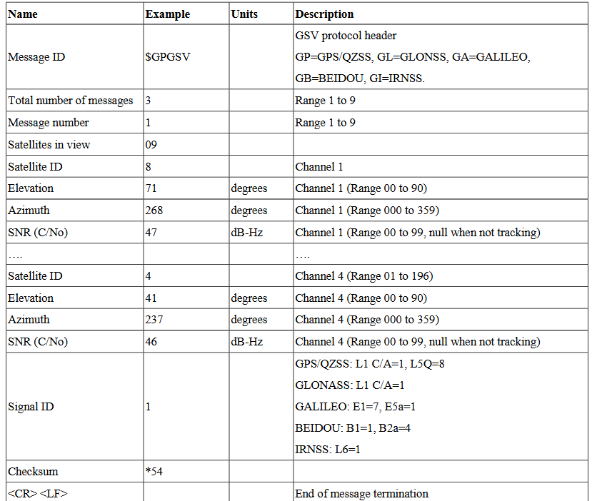

the easiest way is to report here the GSV reported by the module. GSV in NMEA contains the CN0 level.
