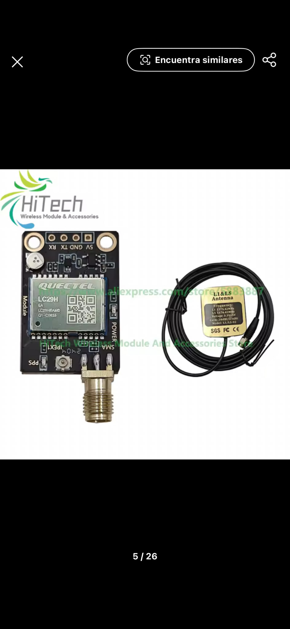

Hi,
I have these LC29HEA, how can I upload the firmware, chatgpt says that I have to press a reset button but it doesnt have anyone.
Thank you!

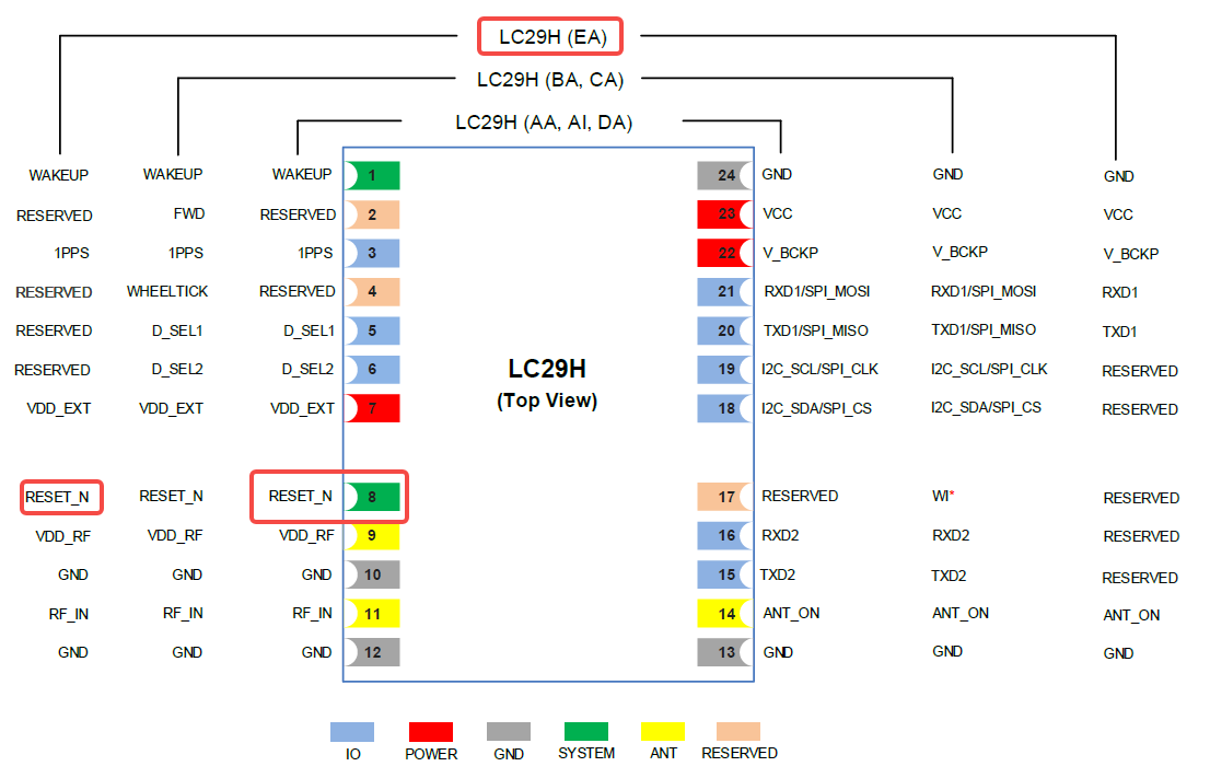

Hi @airplane during the firmware upgrade, if you dont have physical reset button, you may need to use a wire jumper. Then jump the wire from Pin8 (RESET_N) to GND for at least 100ms then release it. See snapshot for the pin assignment below:
