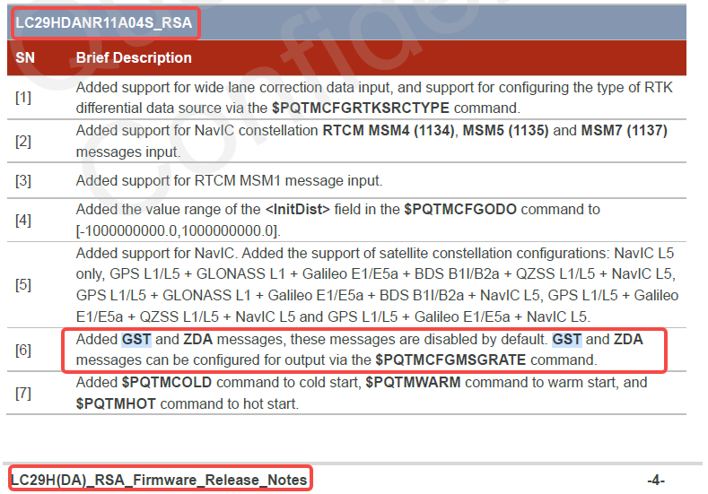

For more information, in the DA firmware version LC29HDANR11A04S_RSA release note, it stated that GST can be enabled as part of new feature releases:

Hi @amlago after further checked with internal team, this process for cross-flashed only for internal usage and testing. Externally, we are highly not recommended for the cross-flash between modules. Please take note that GST and ZDA messages are not supported on EA module.
Even with same chipset and board; different modules version will require different activation codes, and this will directly impact the feature within module such as RTK function.
If the license only for EA module, then its only can be used with EA firmware and this same goes for DA. Hope that will help you for better understanding.
