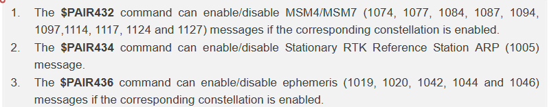

$PAIR432,122 # output RTCM3 MSM7 messages
$PAIR434,1
24 # output RTCM3 antenna position (1005)

add $PAIR436,1*26 ==> set RTCM3.x output with satellite ephemeris
note also $PAIR432,1*22 # output still revert to RTCM3 MSM4 messages after save & reboot.
