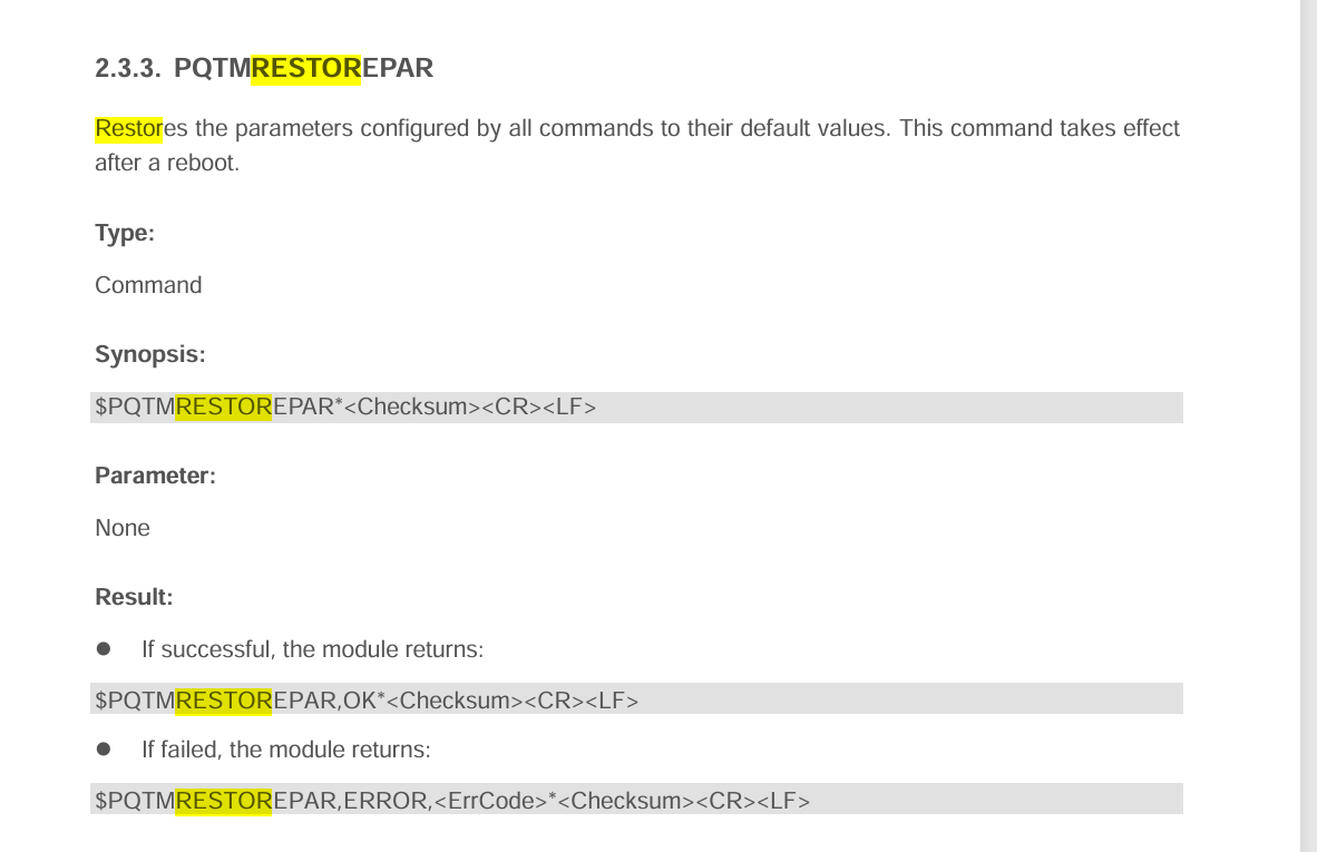

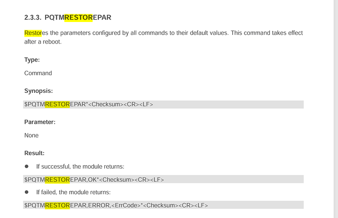

Hi @ckemere
You can also use this command ($PQTMRESTOREPAR*13) to restore the parameters configured by all commands to their default values.
Moreover, i will send the latest firmware of LC29HDA to you through email.
