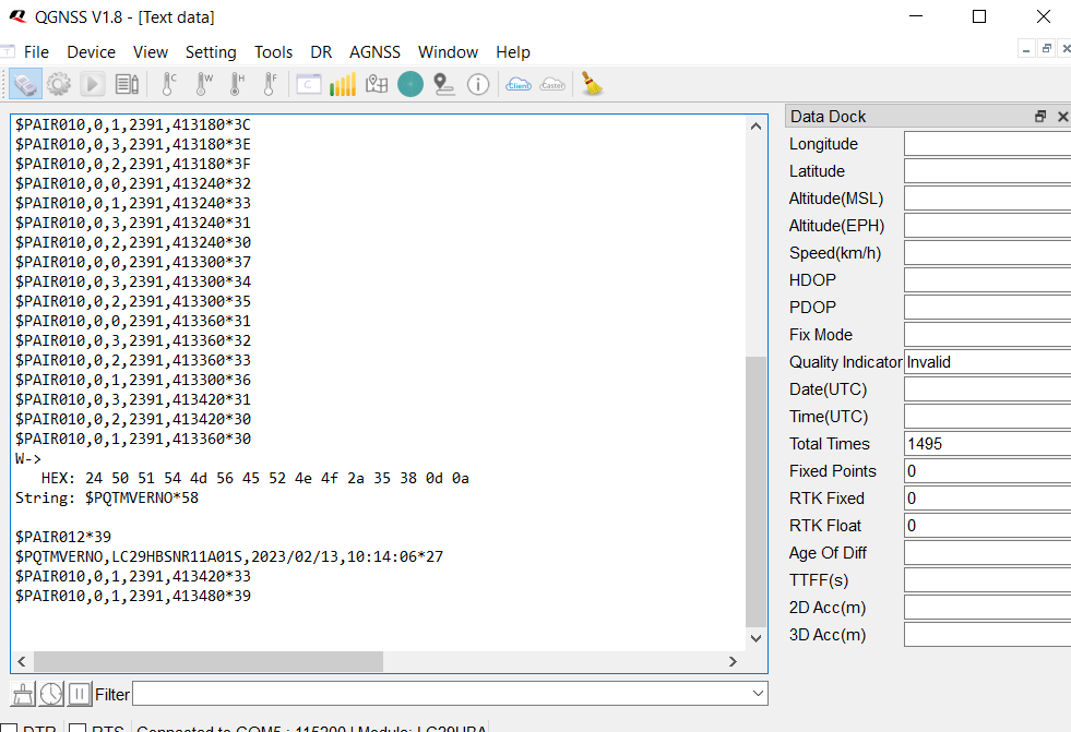

Good morning. I’m having a problem with my LC29H BA module. After turning it on, it doesn’t display coordinates. I don’t know what could be wrong. After executing the command
String: $PQTMVERNO*58
I get this message:
$PAIR01239
$PQTMVERNO,LC29HBSNR11A01S,2023/02/13,10:14:06
27
I’ve included a screenshot below. Could someone help me get this working?

as I remember LC29HBS only outputs RTCM messages by default, and the Fix status will not be displayed on the QGNSS tool!!
Some time ago I also faced the same problems like you. You can find all the necessary information in the forum. Have a look at my posts, they will be useful to you.

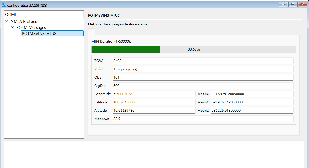

Hi @sp2fix
You can refer to the Survey in coordinate and status using the QGNSS Tool
