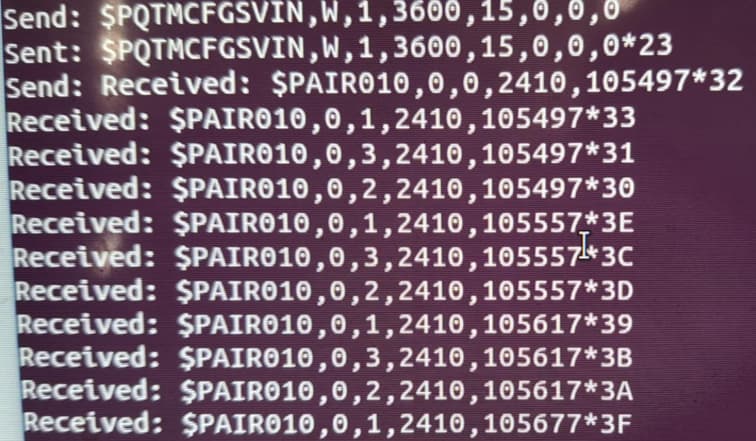

I am having the same problem on the module, it repeatedly outputs $PAIR010…messages. Would it be possible to send the latest firmware so that I can reflash it. The current firmware is $PQTMVER,1,MODULE,LC29HBSNR11A01S,2023/02/13,10:14:06*0D

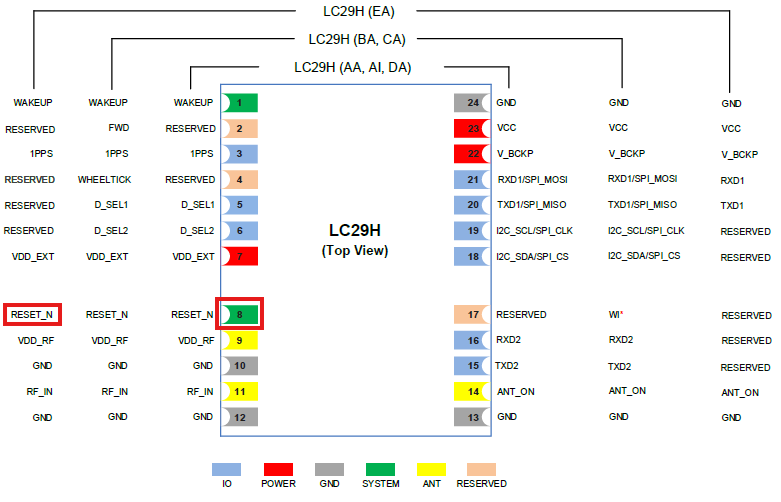

I have sent the FW version to your email. Please do let me know if you have received the FW package. Please note that for LC29H (BS) only has a single version as the module currently towards to EOL product.
To reset the module, please find the below Pin8 (RESET_N) and short it to ground (Active LOW) for 1s.
