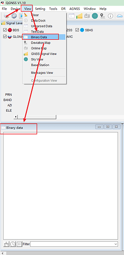

Here the problem: I don’t have recognizable data for USB or UART, and the unique data is the information on text data display.

LC29HBS outputs RTCM data. Therefore, you need to open the Binary data page as shown in the following figure.
