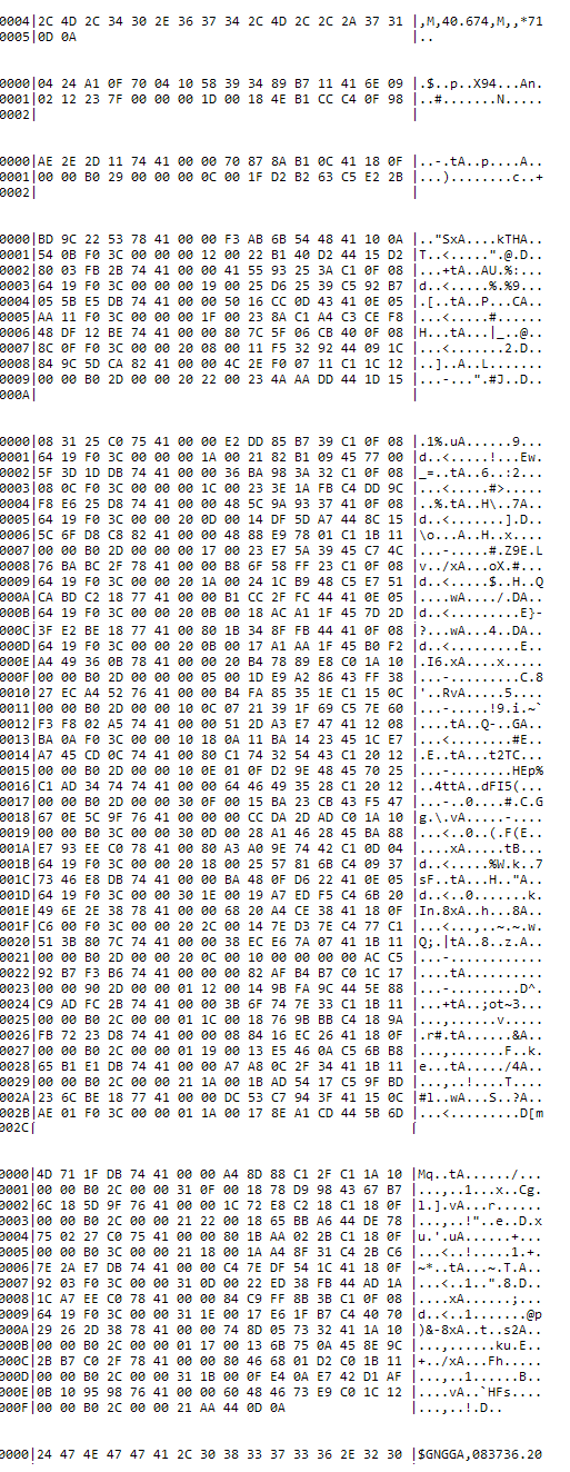

Here bin data of 10Hz raw_data & proprietary sentences and only nmea_GGA

Thanks this interesting. I can now get some raw data out of the LC29H but it is going to be quite a task for me to workout what it is and if it is suitable for Ardupilot. Documentation is limited !
