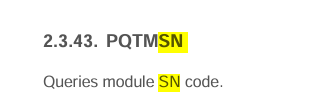

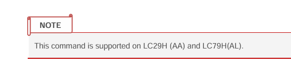

About SN of module. You can scan the QR code on the scanner module to obtain.

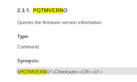

About firmware, you can through this command($PQTMVERNO*58) to query.
