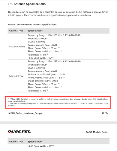

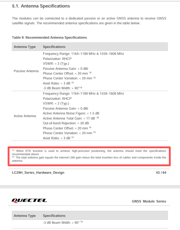

Thanks Jasper. I am seeking the datasheet for the antenna and will revert. As delivered, the antenna has a 3 metre RG174 cable with SMA connector. In that configuration, I can get fixed RTK in most cases. However, I need to shorten the cable to fit the antenna into its normal location. When I shorten the cable to around 80mm (and replace the SME connector), I can no longer get fixed RTK. This confuses as such a short length should not change the impedance or wave length characteristics.
Further on this. The LC29HDA upgrade worked very well - so thank you for that. I have been doing limited testing today using both a Quectel YB0017AA Antenna and this one https://www.aliexpress.com/item/1005007077248776.html?pdp_npi=4%40dis!AUD!AU%20%2426.24!AU%20%2420.99!!!16.89!13.51!%402101e81117622260022226363e33ba!12000039325536360!sh!AU!0!X&spm=a2g0o.store_pc_allItems_or_groupList.new_all_items_2007523699384.1005007077248776 The base station is an LC29HBS unit. The Quectel antenna gives better results but still only a floating RTK (the other antenna, not even that). This however is the same as I am getting with a ublox ZED-F9P rover so I am assuming that sky conditions are impacting. I am comfortable that my issues are antenna related so I will pursue that angle. Regards.
