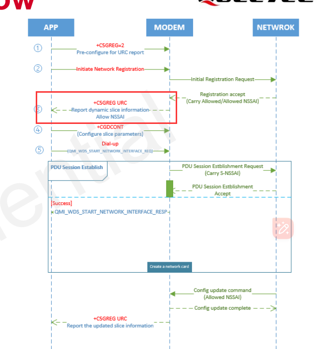

In the thread
there was a screenshot of a Quectel manual (by @Silvia). Would it be possible to get this document?
