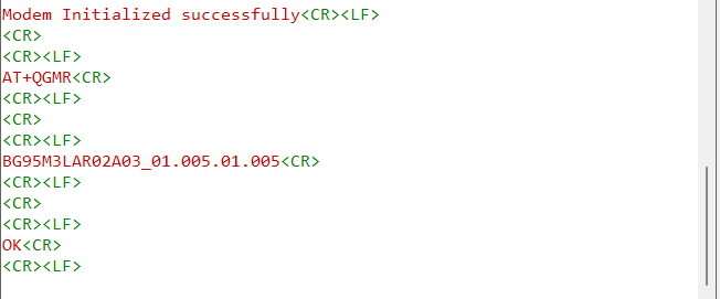

Sorry for my late replay. The modem used in my device has firmware version BG95M3LAR02A03_01.005.01.005

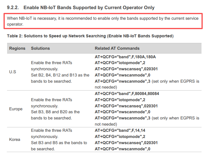

Hello, I have an issue where the module stays in SEARCH or CEREG 0,2, while the BC660 works normally in the same location. Could you please send me the latest firmware version? At the moment I am running AT+QGMR
BG95M3LAR02A03_31.202.31.202
Under the default configuration, the BG95M3 prioritizes the search for catm. This process takes more time. If you give it sufficient time, it will continue to search for NB after completing the catm search. It is likely to complete the registration for NB.
The problem has been resolved. I was trying to attach to NB-IoT using the APN iot.1nce.net with the Quectel BG95 module, while the actual NB-IoT network of A1 Bulgaria requires a local APN for roaming. Thanks herbert.pan-Q!!!
