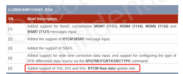

Hi @freakinbill
Thank you for reaching out
The firmware which supports Raw RTCM is LC29HEANR11A04S_RSA
I will send you the latest firmware via email, please let me know if you have trouble downloading.
The RTCM output is enable once it enters Base station mode, to configure this please enter the following command:
$PQTMCFGRCVRMODE,W,2*29
$PQTMSAVEPAR*5A
Reset module

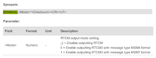

After getting fixed the RTCM will default output RTCM3 data in MSM4 format, you can use the following command to output the desire MSM format
$PAIR432,1*22
Please let me know if you have difficulty in configuring the following steps, i’ll be available to support
