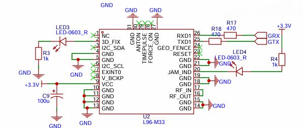

I’m currently using GNSS module L96 in one of my project but i’m facing issue with the GPS fix of the module it is not being able to fix the GPS while studying it is showing it is not being able to discover any satellite even after more than half an hour of being kept in open space. I tried using different L96 modules but facing same GPS fix issue in every L96 module.
SPECS: i’m trying to use internal antenna of device below i’ll show the basic circuitary i used on module.
@quectel2 please help
Hi,
Metal components under or near the module may block the module’s internal antenna from receiving a signal. There should be no metal or ground plane beneath or around the antenna area.
Check your PCB design against Quectel’s reference design guidelines.
Using the module’s communication protocol (PMTK commands), you can verify whether the module uses an internal or external antenna.

Is the issue been resolved? Can you send us the full SCH and PCB design through me email and i will help verify the design.
