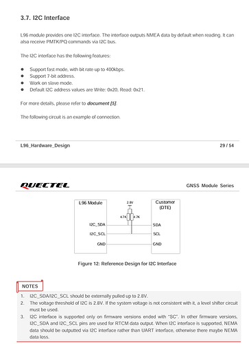

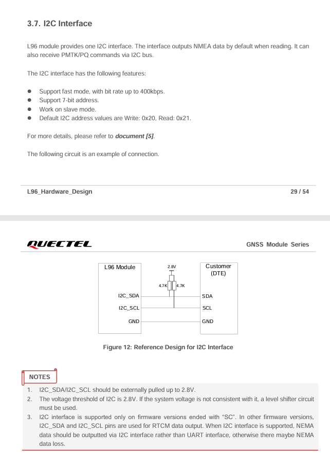

Helllo, my L96 module FW doesn’t support I2C interface. The reply to $PQVERNO is:
$PQVERNO,R,L96NR01A03S,2018/07/30,04:17*6B
How can I get firmware that can be used with QGNSS 2.2 and that supports I2C? Thanks at lot.

I have sent the latest firmware and relative technology document to you through email, please check it.
It is should not relative with firmware, please check your hardware with module. QGNSS2.2 is base on UART to communicate with module. If you want base on i2c to communicate with module, please use specific i2c tool.
