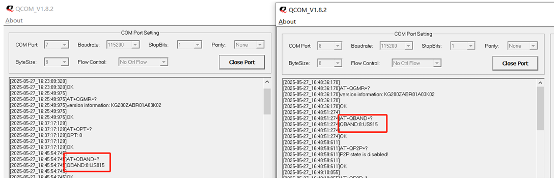

(1) Connect KG200Z EVBs to QCOM tool via USB cables
(2) Make sure your KG200Z TEB or module is running AT firmware using AT+QVER
(3) Check the band information on EVBs by running AT+QBAND=? Command

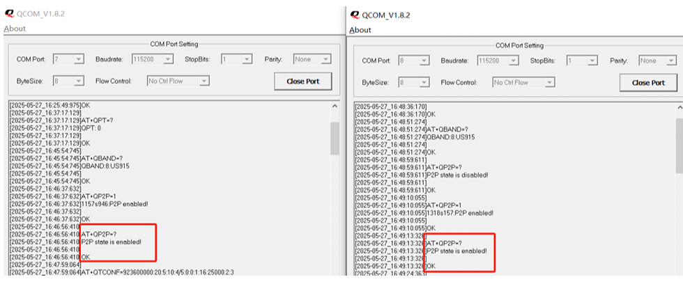

(4) Turn on the P2P feature by running AT+QP2P=?
(5) Transmit (TX) Side:Set TCONF using AT+QTCONF command
(6) Receive (RX) Side: Set TCONF using AT+QTCONF command

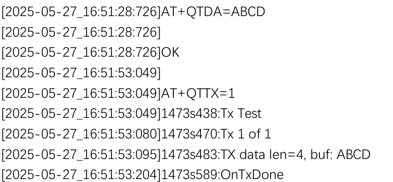

(7) Transmit (TX) Side:
  • AT+QTDA=ABCD
  • AT+QTTX=1
**Important: Always set the payload using AT+QTDA before executing AT+QTTX= to send data.
