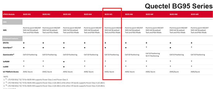

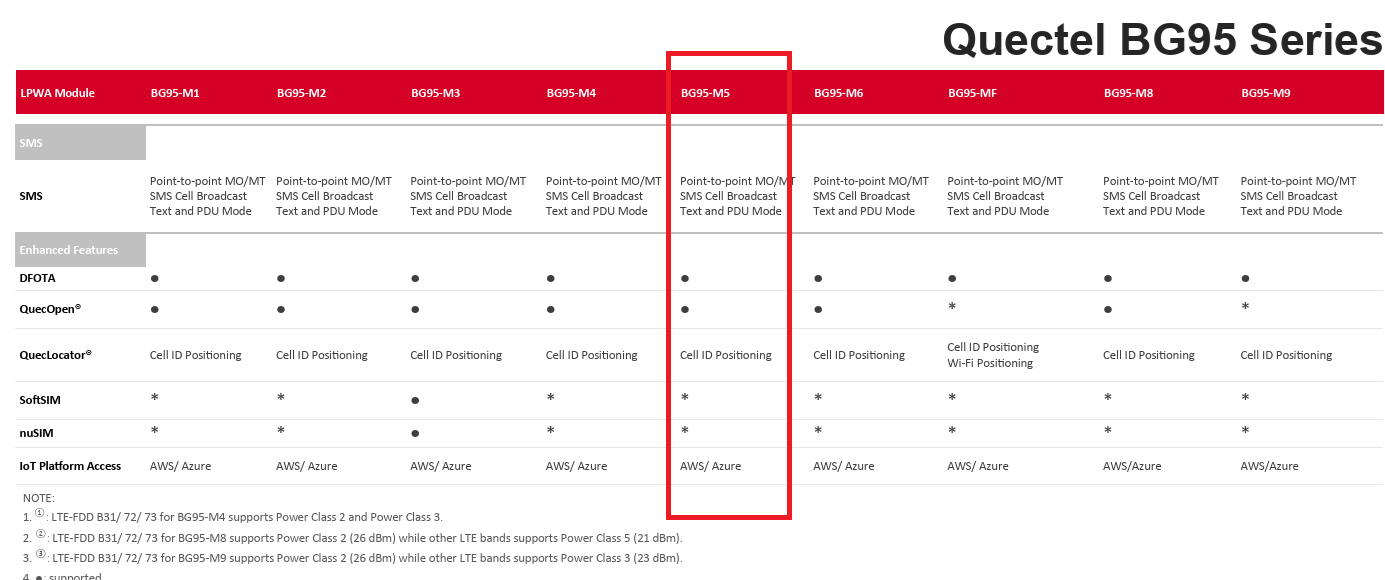

The eSIM feature is not visible in the BG95-M5 module.
This may be the reason why you get an error when using the AT+QCFG command.

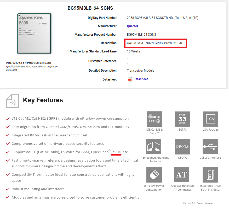

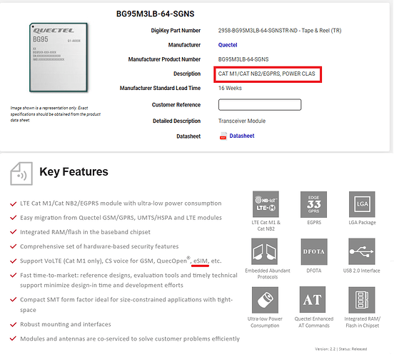

Hi,
Yes, only the BG95M3 datasheet shows e-SIM. The modules you sent have different features. They state this in the Digikey description section. You can get more accurate information by contacting the sales department in your country when selecting a product.
Description RF TXRX MOD CELL NAV SMD
Description CLOUD ENABLED, CAT M1/CAT NB2/EG
Description CAT M1/CAT NB2/EGPRS, POWER CLAS
