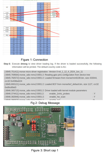

I am working with the FGH100M-ZIO-TE-B_V1.1 WiFi HaLow Module . I have connected the WiFi HaLow module to Jetson Orin Nano development board through SPI communication protocol, to set it as Access Point(AP). The connection between them is shown in Figure 1.
For setting it as AP, I have configured the device tree of Orin Nano for SPI and loaded the morse.ko and dot11ah.ko using insmod.
But when I loaded morse.ko, it is showing registration information only.
“Morse Micro Dot11ah driver registration. Version 0-rel_1_12_4_2024_Jun_11
[ 91.185487] morse micro driver registration. Version 0-rel_1_12_4_2024_Jun_11”
And it is not printing other information and creating dev/morse_io node as shown in Figure 2:
First of all, I need to check whether the device is turned on perfectly. Is there any status LEDs on the FGH100M-ZIO board? As of now, no LED’s are turned ON.
I am providing supply from the Jetson Nano board to FGH100M-ZIO through 5V and GND pins,. Also the shorcap1 connected to the right only. The short cap 1 is shown in Figure 3

There is no such LED. It is RF Wi-Fi and so it cannot work seperately.
We can check the state of the RESET、WAKE pin、VBAT of the FGH100M.
Thanks. I have checked VBAT, VDDFEM and VDDIO. The voltages on those pins are 3.38V. So the module would be working. In the FGH100M Hardware Design Manual, it is shown that we can switch to SPI mode by controlling SDIO_DATA3 and SDIO_CMD. So would I have to do any additional settings other than loading its driver, to operate FGH100M in spi mode?
Also is there any role for WAKE and RESET pins at starting?
There is no special settings. Maybe you can check the status of the wakeup_in and reset. It should be high level.

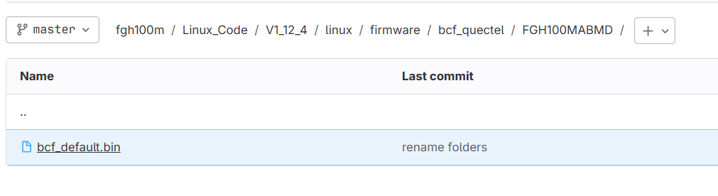

2.The FGH100M-ZIO-TE-B WiFi HaLow module has FGH100MABMD chip. The driver, I am using is Version 0-rel_1_12_4_2024_Jun_11.

Please check the md5 of the bcf_default.bin and the mm6108.bin.
Yeah I checked those:
