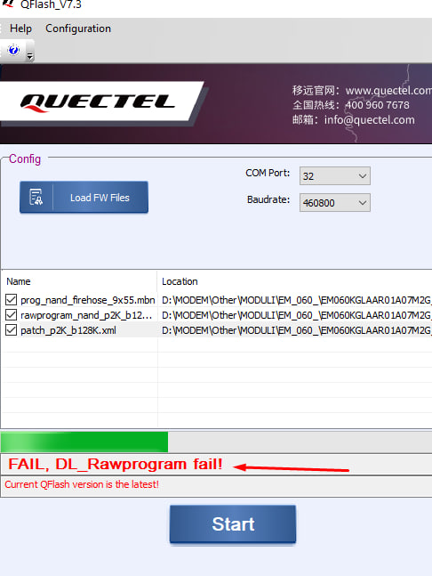

I found the firmware EM060KGLAAR01A07M2G_01.001.01.001
and EM060KGLAAR01A08M2G_01.001.01.001
but how to flash, the firmware gives an error all the time
The firmware is not match with the module you used.
