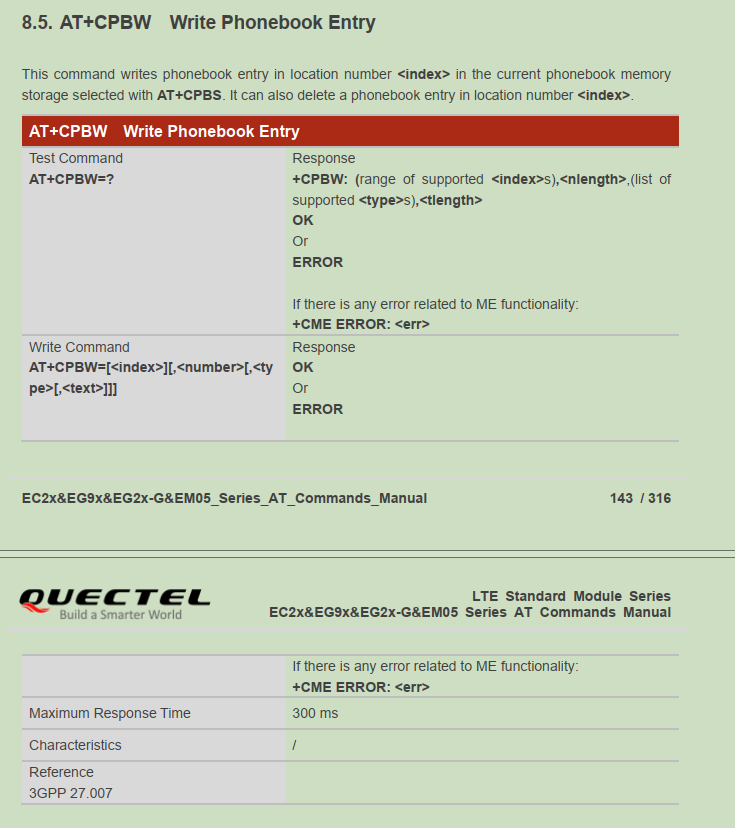

Hi @compact
Can you try on AT+CPBW?
thanks for replying :grinning:

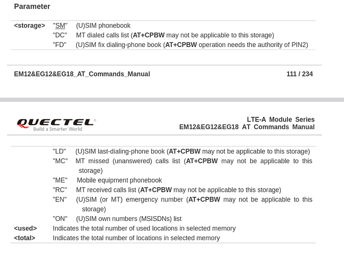

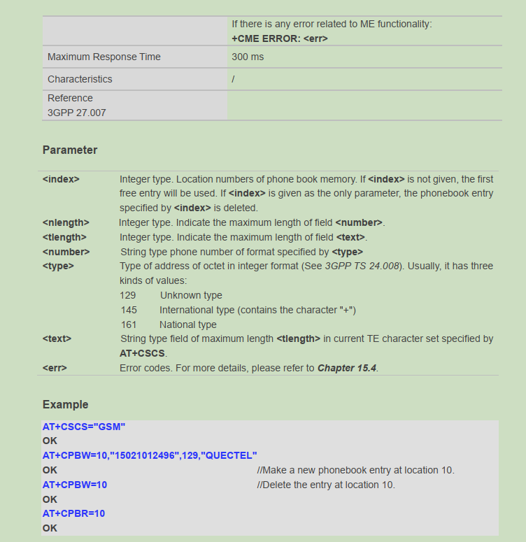

I tried with the command “AT+CPBW=1” but it doesn’t work.
The documentation says that the command “AT+CPBW” is not applicable to the “MC” storage.

AT+CPBW=1
+CME ERROR: 3
AT+CPBW=2
+CME ERROR: 3
AT+CPBW=3
+CME ERROR: 3
