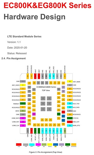

Here is the schematic of the standard version:
And here is the schematic of the QuecPython version, found on Quectel Developer Zone:
I also need clarification on whether these are different hardware models or simply different firmware/configurations:
  • EG800KLALC-I03-TA0AA
  • EG800KLALC-I03-SNSAA
  • EG800KLALCR07A04M04_OCPU_QPY
  • EG800KLALCR07A03M04_OCPU_QPY
From the part numbers, I understand that LALC refers to the variant and certifications, I03 to the hardware version, and the suffixes (TA0AA, SNSAA, etc.) might indicate firmware packages or specific functional configurations (for example, QuecPython enabled with GPIO support). Could someone confirm if these suffixes correspond to different physical hardware or if it’s only a matter of firmware build and feature set?

1,The EG800K module offers three software solutions: the standard solution (using AT commands), the QuecOpen solution (based on C language), and the QuecPython solution (using Python language). These are merely different software solutions, and they share the same hardware.
2
EG800KLALC-I03-TA0AA is is a board, and we call it TE-A.
EG800KLALC-I03-SNSAA is a module
The following two are different versions of the firmware. Version A04 is newer than A03, and we recommend using the new firmware for debugging.
Hope this answers your questions. If you have any further inquiries, please feel free to stay in touch.
