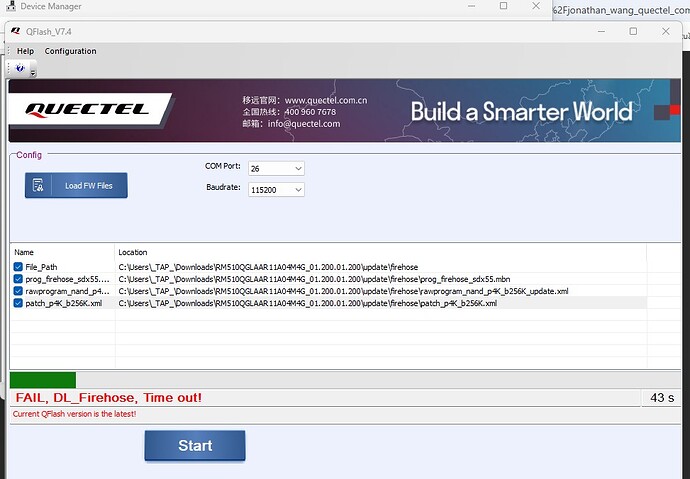

I have already received the firmware version RM510QGLAAR11A04M4G_01.200.01.200
But which file should I select in QFlash_V5.8_EN tool.

Dear @ketan.asm
Please select the file below:
The latest version of QFlash is V6.3, I have sent it to you via Message, please check.
Hi,
I have updated the firmware from RM510QGLAAR11A04M4G_01.001.01.001 to RM510QGLAAR11A04M4G_01.200.01.200 by selecting following file…
“RM510QGLAAR11A04M4G_01.200.01.200\update\firehose\prog_firehose_sdx55.mbn”
Now the issue is, If I give command AT+QSCAN=2,1 (To scan 5G SA) no output is returned, just OK
