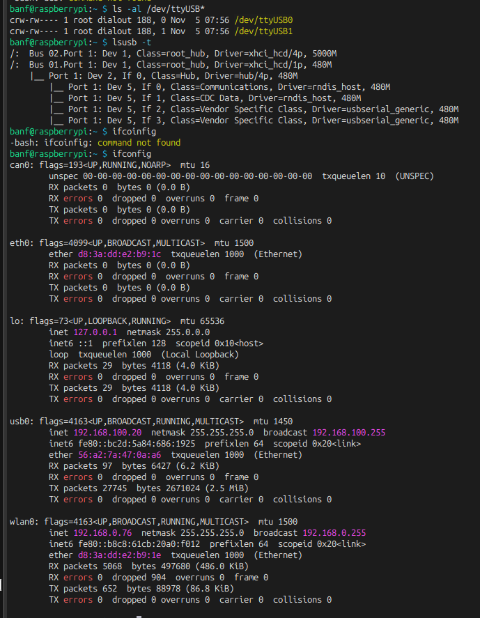

Hello, I am trying to use the EC25-EU module on the Raspberry Pi 4b board. But something is not easy.
  1. First, I plugged the EC25 into the board and recognized the USB as follows. However, only ttyUSB0 and ttyUSB1 were recognized. The manual document states that ttyUSB2 and ttyUSB3 are also recognized.
I need your help.

Hi Friend,
Just from the pictures you provided, the EC25 is not recognized as I guess.
Have you ever modified the USB VID and PID of the module?
05c6 9059 is not the Quectel product. Please check it carefully.

I have build the Raspberry Pi 4b source code and reinstalled the kernel. 6.6.69 v8+
Now 3 ttyUSB1, 2, and 3 are recognized. And it was recognized as cdc, not rndis.
Is it really not an EC25 module? <05c6 9059>
I am sure it is not the Quectel EC25.
You can try to send the AT+CGMR via ttyUSB2 or ttyUSB3. And we can see the firmware version of it.
