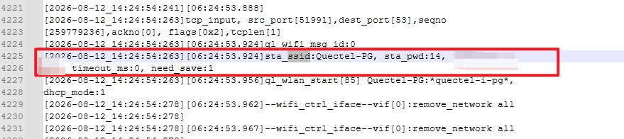

Method 2: Capture credentials via UART0 debug log and forward via MCU
Since the FCM360W operates as a peripheral in your AT command setup, your host MCU can monitor the UART0 debug log output during WebCfg provisioning. When a user submits WiFi credentials through the WebCfg web page, the SSID and password are printed in the debug log, as shown below:
Your MCU firmware can parse this log to extract the SSID and password, store them locally, and then issue AT+QSTAAPINFOor AT+QSTAAPINFODEFto reconnect the module to the WiFi network automatically, based on your MCU-side program logic.
