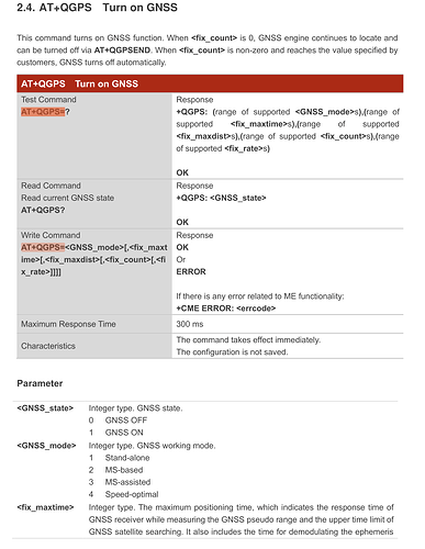

but my module just supprt mode 1
AT+QGPS=?
+QGPS: (0,1)
OK
AT+QGPS=1

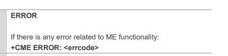

+CME ERROR: 504
how I can use mode 3 or 4

Hi @mohand_zaatreh
“AT+QAGPS=1” This command is to enable auxiliary positioning, which can help you obtain positioning information faster.
I didn’t find this command here
where can I find this cmd?
Please refer to the usage process of AT+QGPSXTRA for the instruction manual you are using.The function of this command is also to accelerate positioning.
