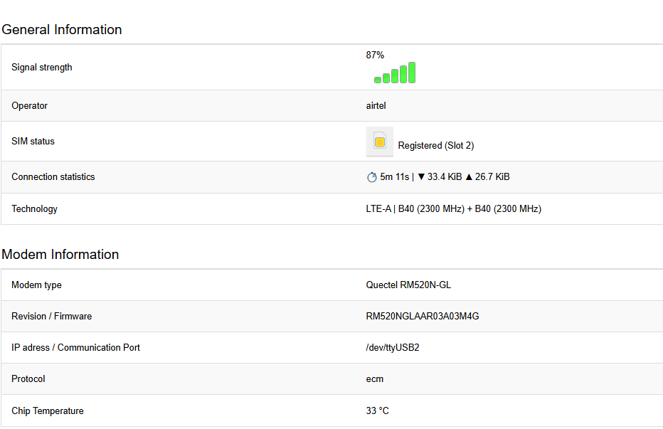

Dear Silvia,
My firmware version is RM520NGLAAR03A03M4G, model -Quectel RM520N-GL, following screenshot you may see.
I have NSA network of Airtel

Dear @shailesh170
Please make sure “” are English character.
