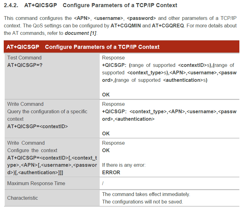

It might be better to use the QICSGP + QIACT method, which is typical for the EC200U’s TCP/IP stack.
AT+CGDCONT: 3GPP standard PDP definition (core register side).
AT+QICSGP: Profile to which Quectel will bind for its internal TCP/IP stack (HTTP/TCP, etc., commands work with this).
AT+QIACT: Activates the profile defined with QICSGP.
If left as CGDCONT, the QHTTP/TCP side will not see QIACT, so it will typically result in a +CME ERROR: 58.

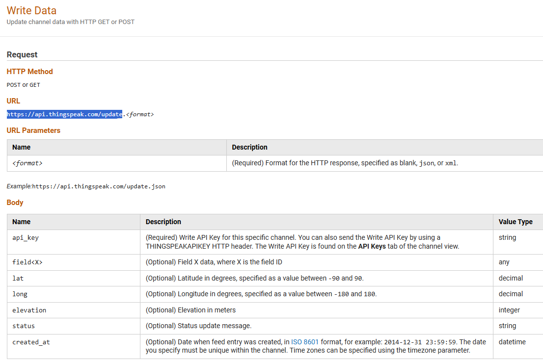

http:// api. thingspeak. com/data - The endpoint for writing data to ThingSpeak should be /update.
Also, the URL length is incorrect.
You entered AT+QHTTPURL=25.60 and sent a 30-byte URL. The first parameter in the QHTTPURL is the byte length of the incoming URL (must be entered exactly correctly).
The POST body length is incorrect.
You sent the body:
api_key=W5WWY7QVTH1NL85M&field1=25.3&field2=60.5
Its length is 48 bytes. You specified AT+QHTTPPOST=42.60 → it’s a partial send, and the server returns 400.
There’s also an error in the auth parameter.
AT+QICSGP=1,1,“airtelgprs”,“”,“”,1 → if the user/password is empty, it’s more correct to use auth 0: …,0
AT+QICSGP=1,1,“airtelgprs”,“”,“”,0
AT+QHTTPURL=32,80
CONNECT
http://api.thingspeak.com/update
// Module: OK
// POST body (length: 48)
AT+QHTTPPOST=48,60
CONNECT
// Module: OK
// +QHTTPPOST: 0.200,<len> // You should see 200
// If you get 400, look at the length numbers again.
