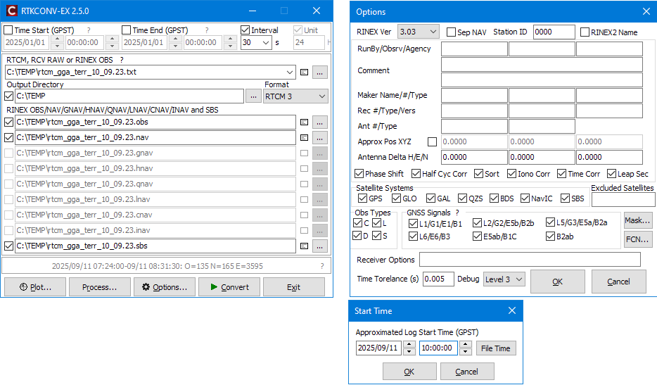

For convert logged rtcm data to RINEX just use rtklib suite, RTKCONV can do the job: .obs & .nav are the files…
Thanks. So the source file is the .txt log file, and the output files are the .obs and .nav? How do you get the .txt log file? Can I use “Bluetooth GNSS” to collect such logs? How do you personally get your .txt log files?
Just check log button…
I use lefebure app
and once checked Save GPS Data to File
log are in Download > NMEA-YYYY-MM-DD.txt

It now seems to work with Lefebure logs, I just need to explicitly select RTCM3 format on rtkconv, whereas it just won’t work with Bluetooth GNSS logs. I’ll compare logs formats/contents later.
