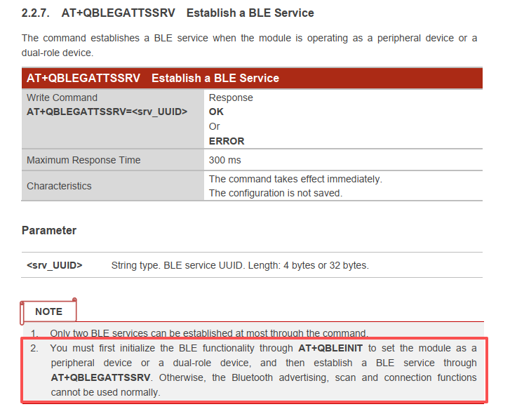

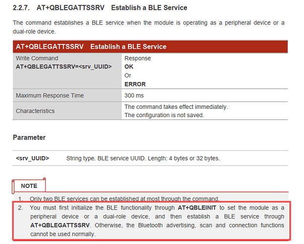

  1. pls note
  2. try change \r to \r\n

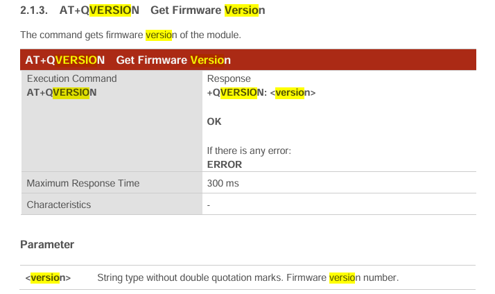

I will add getSwVersion command so i can add SwVersion of the module in this Topic

Please try using another UUID. If the error persists, I will attempt to verify.

For version query, you may use AT+QVERSION to query.
