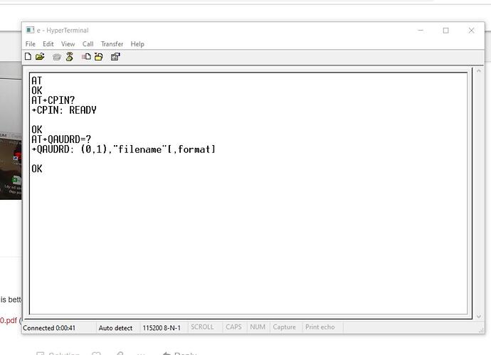

Whether you have design the audio circuit ? If that, it is better to check whether the module support the command AT+QAUDRD=?.
Quectel_GSM_Module_Audio_Design_Guide_V3.0.pdf (1.2 MB)
it works but I get Error 4010

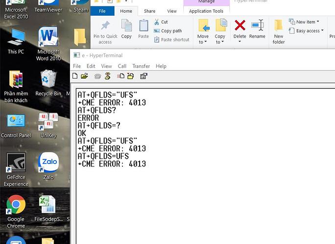

Please make sure the store path have enough space. You can use command at+qflds=“UFS” to confirm it. Thanks!
Error 4013
It works with AT + QFLDS = “RAM” device. I want to record successful sound. And now I want to play music to do what to do. It does not work with AT + QAUDPLAY = “1122.Wav”, 0
