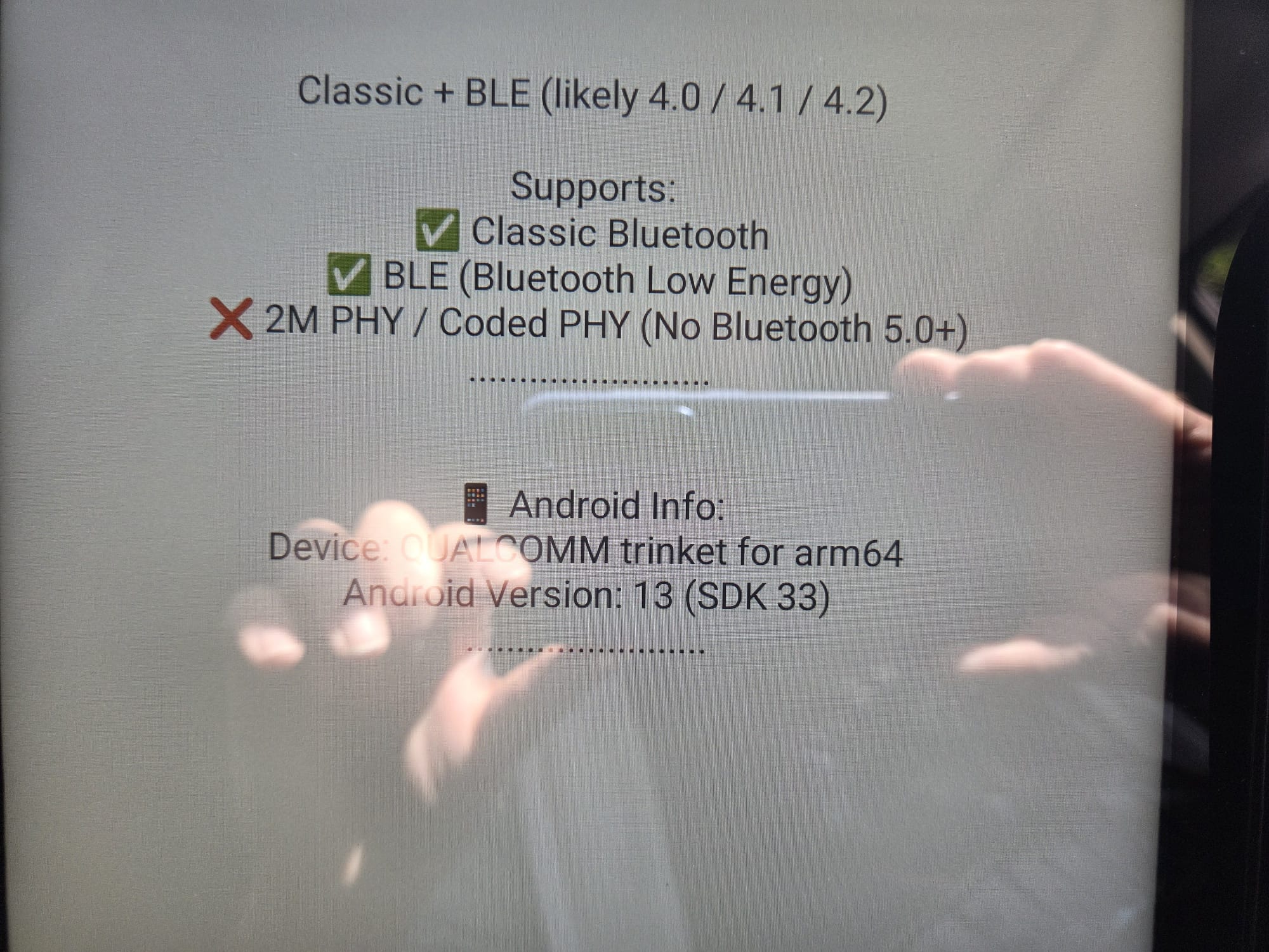

Hello I have an aftermarket head unit that I am trying to identify the OEM, it’s a rebranded unit here in Australia. Is the BT device capable of BT 5+, is there an update bluetooth version available
I am having an issue connecting a bluetooth device which has lead me here. According to the output below the device has a qualcomm bluetooth device.
Is there a toolset that I can use to debug the device connection so that I can hopefully see where the issue is?
Thanks in Advance.

I don’t think this unit is from Quectel, so it’s best to contact the head unit’s manufacturer or the reseller you bought it from. Also, the Bluetooth version is usually fixed by the chip’s hardware and firmware, so it normally can’t be upgraded with an update.
To help narrow down the connection issue, can you tell us what Bluetooth device you’re trying to connect, and whether it uses BLE or classic Bluetooth? Common causes are:
  • The device is BLE-only, and the head unit only supports classic Bluetooth (or the other way around).
  • The head unit doesn’t support the profile the device needs, such as HID, A2DP, HFP or SPP.
Check the head unit’s specs to see which profiles it supports.
For the troubleshooting, you can try enable Bluetooth HCI snoop log in Developer Options and check it in Wireshark.
