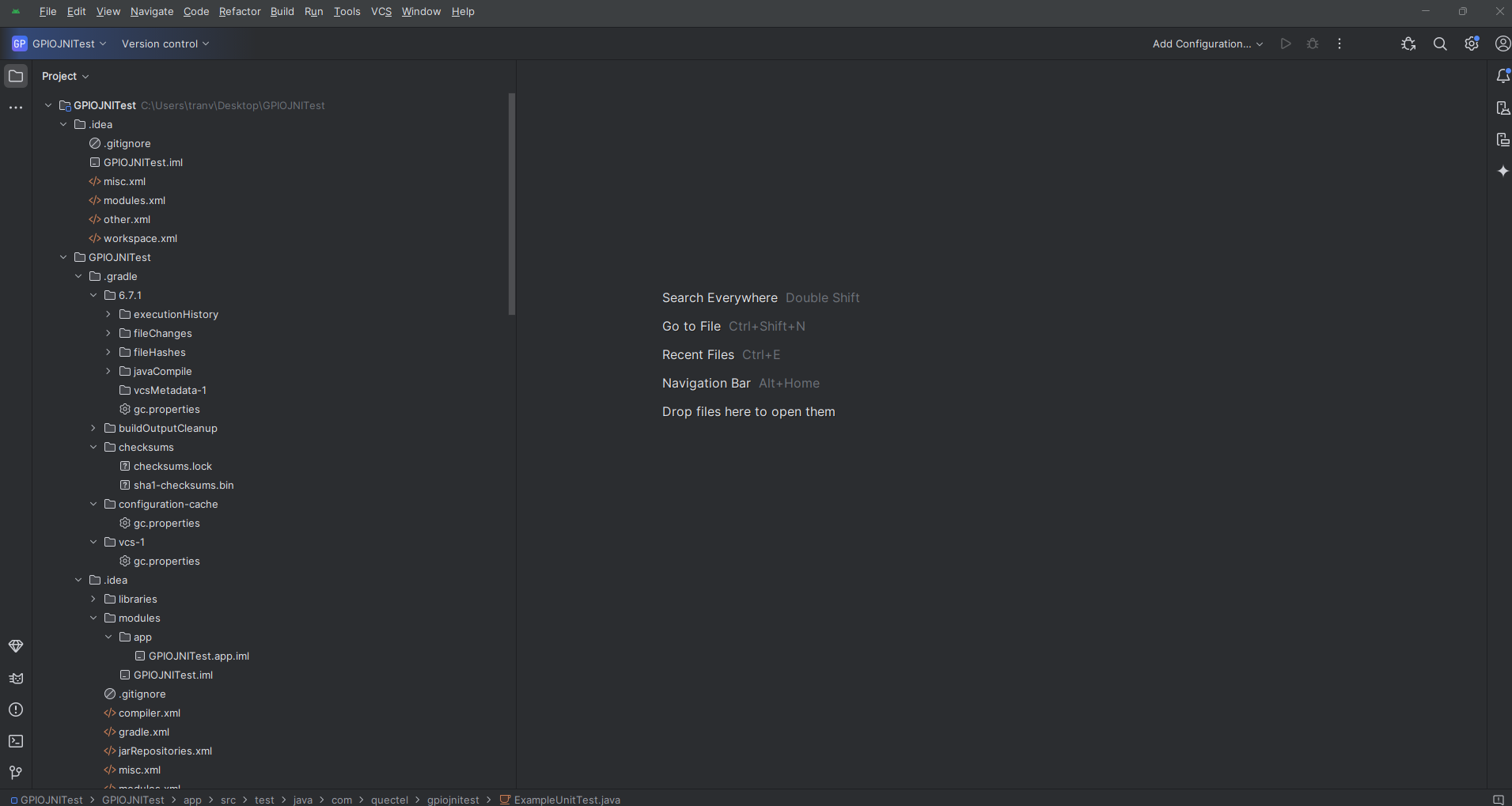

The project needs an Embedded JDK, and I check from Oracle website, it have Java SE Embedded, but all extensions is tar.gz, so does that means this project run on Andoid Studio in Linux operating system, ubuntu for example. Is that correct?
hi,
You can use your own Android SDK.
Just click OK button to change the SDK path to yours.
