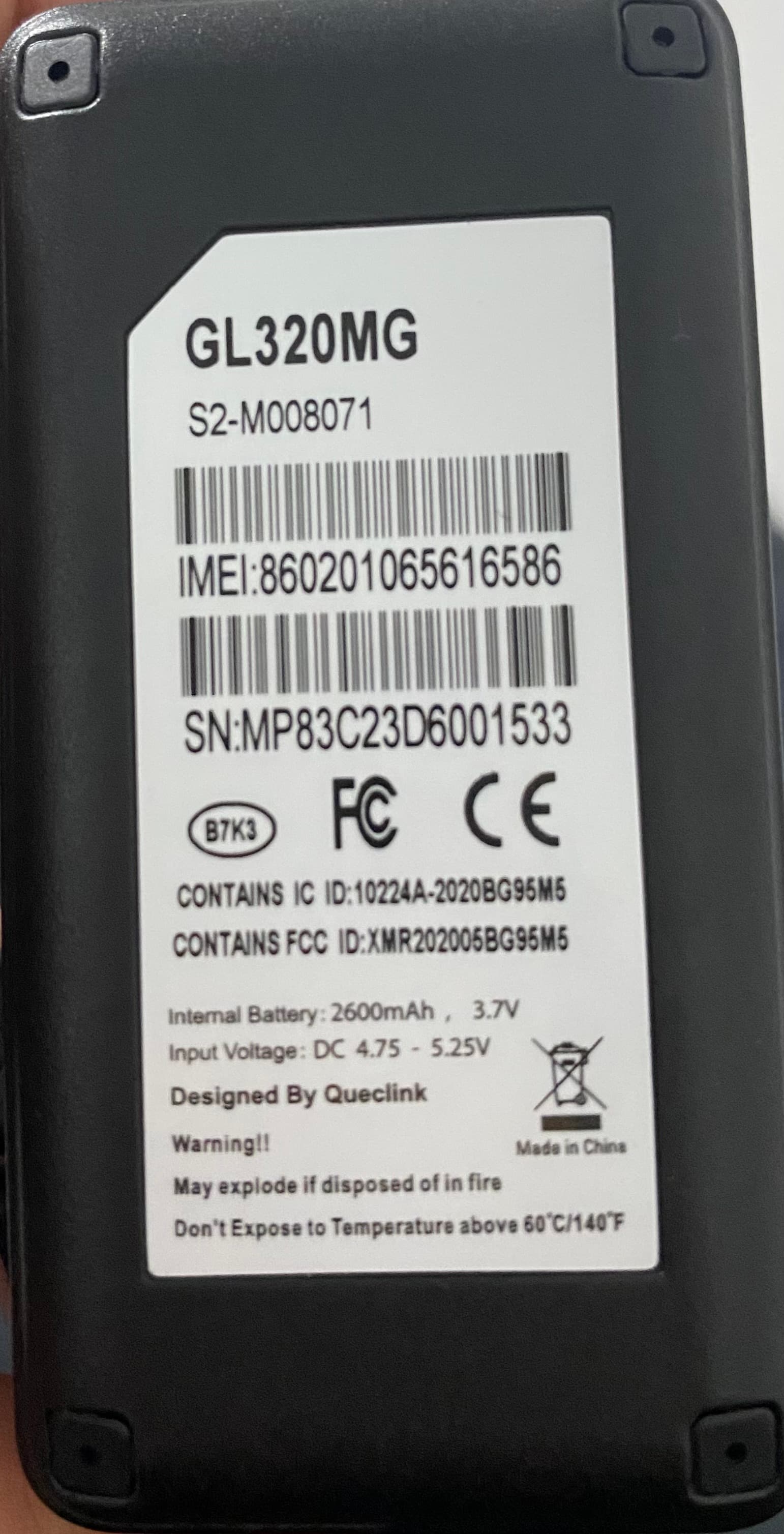

Im having issues with find driver for a GL320MG and I have installed the prolific drivers and keep getting this displayed on device manger on windows 11 LPWA Module not installed
It seems like not Quectel products.
GL320MG | Queclink-Driving Smarter IoT
How is it not when you guys have a manufacturer of the device
Queclink is another manufacturer.
Please check with the vendor or the salesman.
