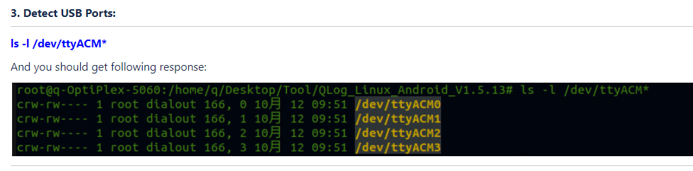

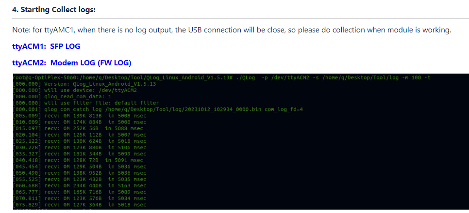

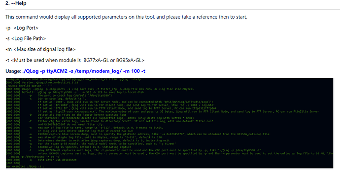

You can try to send AT command when getting logs and refer to this process.
