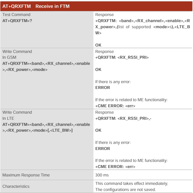

  1. If your goal is to force the module to listen to a specific operator’s tower to measure its signal without registering, you should use Factory Test Mode (FTM.
    This mode allows you to bypass the protocol stack’s registration logic and control the radio hardware directly.
You may follow the steps below to use FTM
  1. Enter FTM
Execute AT+QRFTESTMODE=1.
  1. Force Reception on a Specific Frequency: Use the AT command below to tune the radio to a specific band and channel (EARFCN for LTE or ARFCN for GSM).
AT+QRXFTM
  1. Measure Signal Strength: The command will return <RX_RSSI_PRI>, which is the actual signal strength (in dBm) received at that specific frequency.
    This method forces the module to act as a receiver for that specific tower, effectively making it the “serving” source for your measurements.

Hi AmarRaaj thx for your answer.
I’ve been trying your approach but I can Enter QRTESTMODE but QRXFTM always gave me “ERROR”
This is what I’m doing

[00:47:50] [LTE] Entrando en modo Factory Test Mode (FTM) para operadora 21407…
[00:47:50] [LTE] Sending command: AT+QRFTESTMODE=1
[00:47:51] [LTE] Respuesta recibida: OK
[00:47:52] [LTE] Midiendo señal con FTM (EG25): Banda 7, EARFCN 3034
[00:47:52] [LTE] Sending command: AT+QRXFTM=7,3034
[00:47:52] [LTE] Respuesta recibida: ERROR
[00:47:53] [LTE] Midiendo señal con FTM (EG25): Banda 3, EARFCN 1300
[00:47:53] [LTE] Sending command: AT+QRXFTM=3,1300
[00:47:53] [LTE] Respuesta recibida: ERROR
[00:47:53] [LTE] Midiendo señal con FTM (EG25): Banda 7, EARFCN 2850
[00:47:53] [LTE] Sending command: AT+QRXFTM=7,2850
[00:47:54] [LTE] Midiendo señal con FTM (EG25): Banda 20, EARFCN 6300
[00:47:54] [LTE] Sending command: AT+QRXFTM=20,6300
[00:47:54] [LTE] Respuesta recibida: ERROR
[00:47:54] [LTE] Saliendo del modo Factory Test Mode…
Thx for your Help
