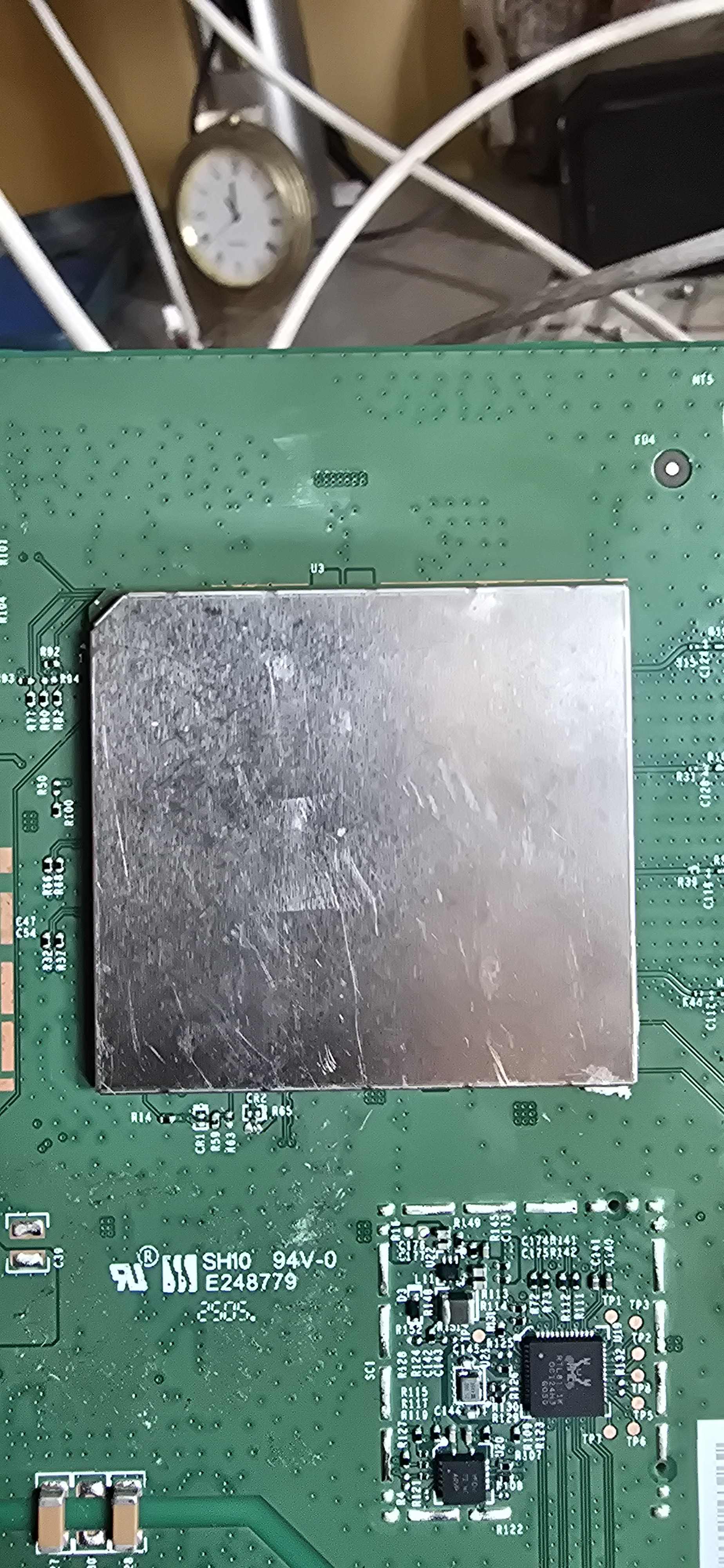

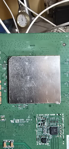

Please share a picture of your RG520F, I need OC information.
Nothing written on the chipset cover. I also placed components for simcard but it is not working. I need AT command access to enable this. Please guide
Dear @Amit_Aniket
Sorry about this.
I am not sure which module you have.
It is better to contact with your supplier to get support.
