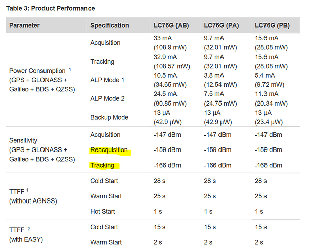

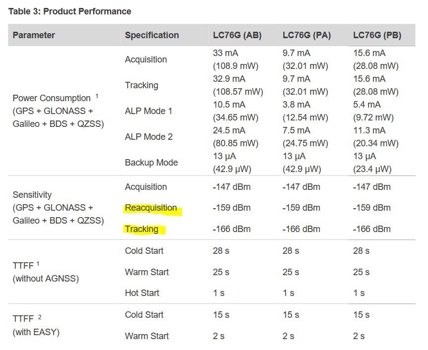

Dear @george.gao ,
additional question.
Looking at the hardware design guide, what is the difference between re-acquisition and tracking?
How to measure? is with AGPS?
thanks

Hi @carlitos18
Reacquisition means that after 12.5 minutes of module positioning, the satellite signal is completely lost (the module is powered on), and then the satellite signal value becomes -159dBm. The module can successfully locate.
Tracking means that after 12.5 minutes of module positioning, the satellite signal gradually decreases to -166dBm, and the module can still locate.
The above parameters are all tested under the instrument.
