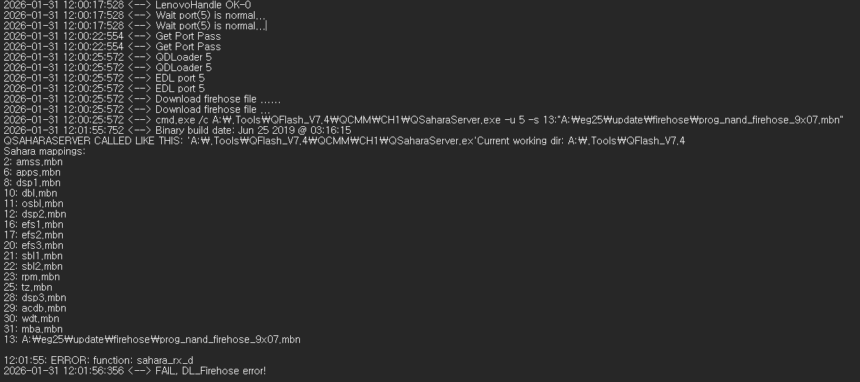

hello, currently it fails on sahara downloading.
