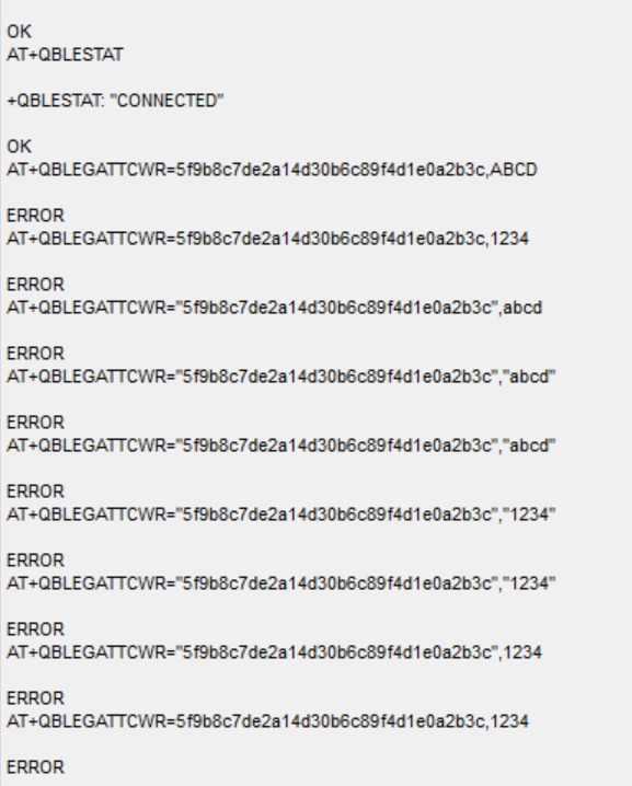

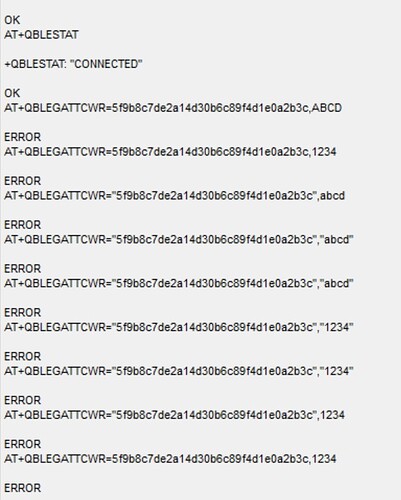

We are trying to use FCM360WA as a BLE Central mode device.
We are able to initialize, connect to peripheral but are unable to send/receive data. “AT+QBLEGATTCWR”

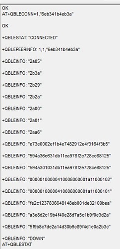

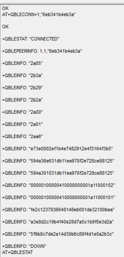

Also what does this [+QBLEINFO: “Down”] means.
Thank you.

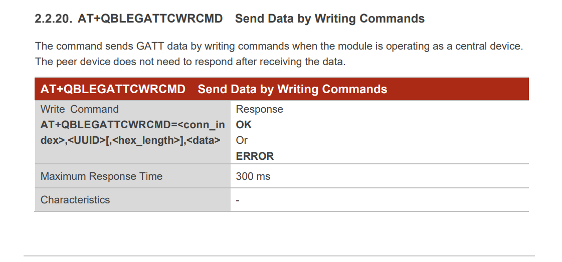

hi Saad,
Please check the AT command:
Thank you.
It worked. Can you share any (latest) FCM360W AT command manual.
