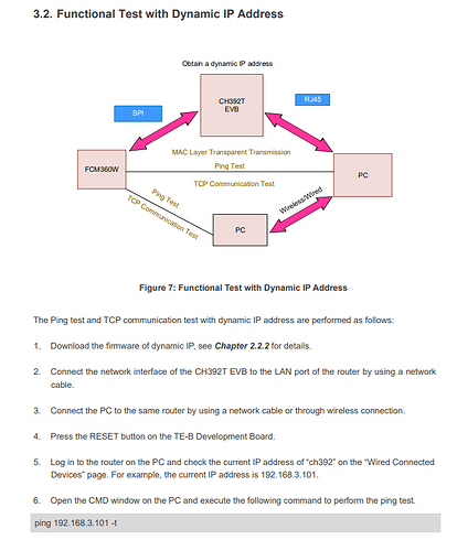

We have FCM360W as SPI network card solution, as shown below. If it meets your needs, I will send you the solution.
