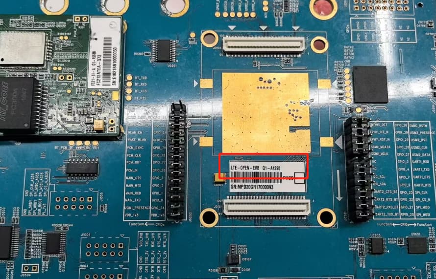

Hi smin0711,
The BT UART hardware of the UMTS EVB is not connected, If you want to test Bluetooth function you must use our LTE-OPEN-EVB.
